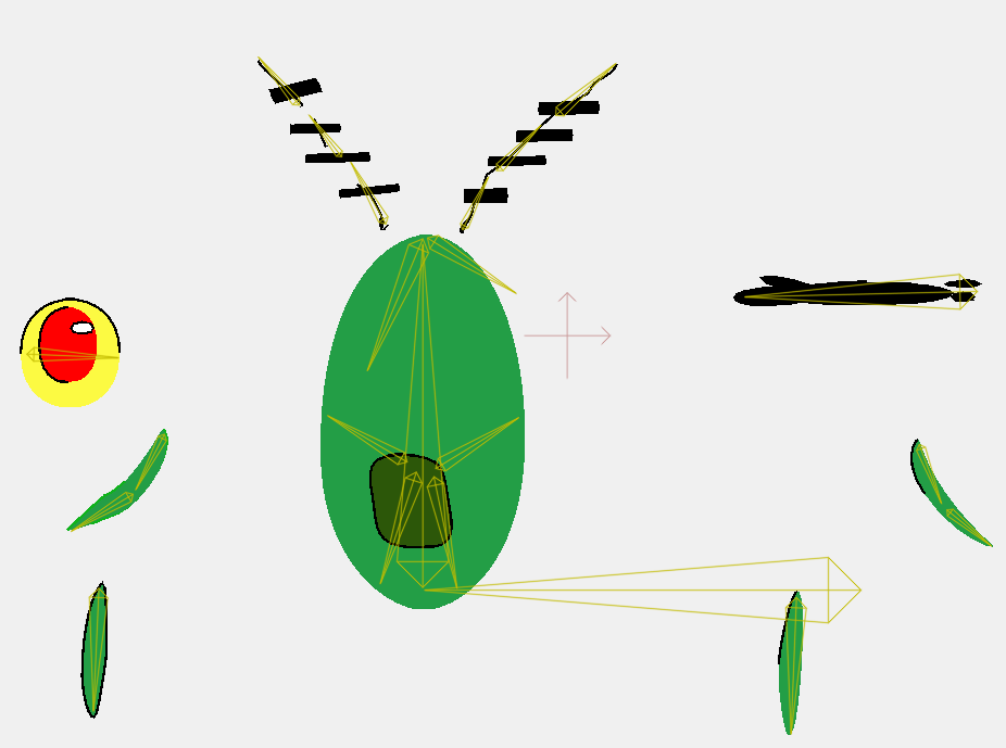

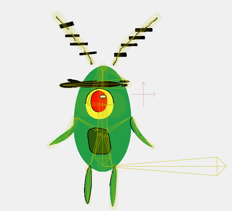

The vector layer is not in the bone layer, so no wonder moving the bones gives you no result ...
Grab the vector layer and drag it over the bone layer until this turns red, then release. Now it's inside, just like a file in a folder.
I'll advise to erase all those bones and start from scratch.
(Edit: I just did it myself and noticed that the file is seriously fucked up. I don't know how you did it, but it's better to start again with a completely new file.
Anyway, here are two screenshots to give you an idea how your character could be rigged. The first shows how you should arrange all parts apart from each other, the second is after assembly.)
