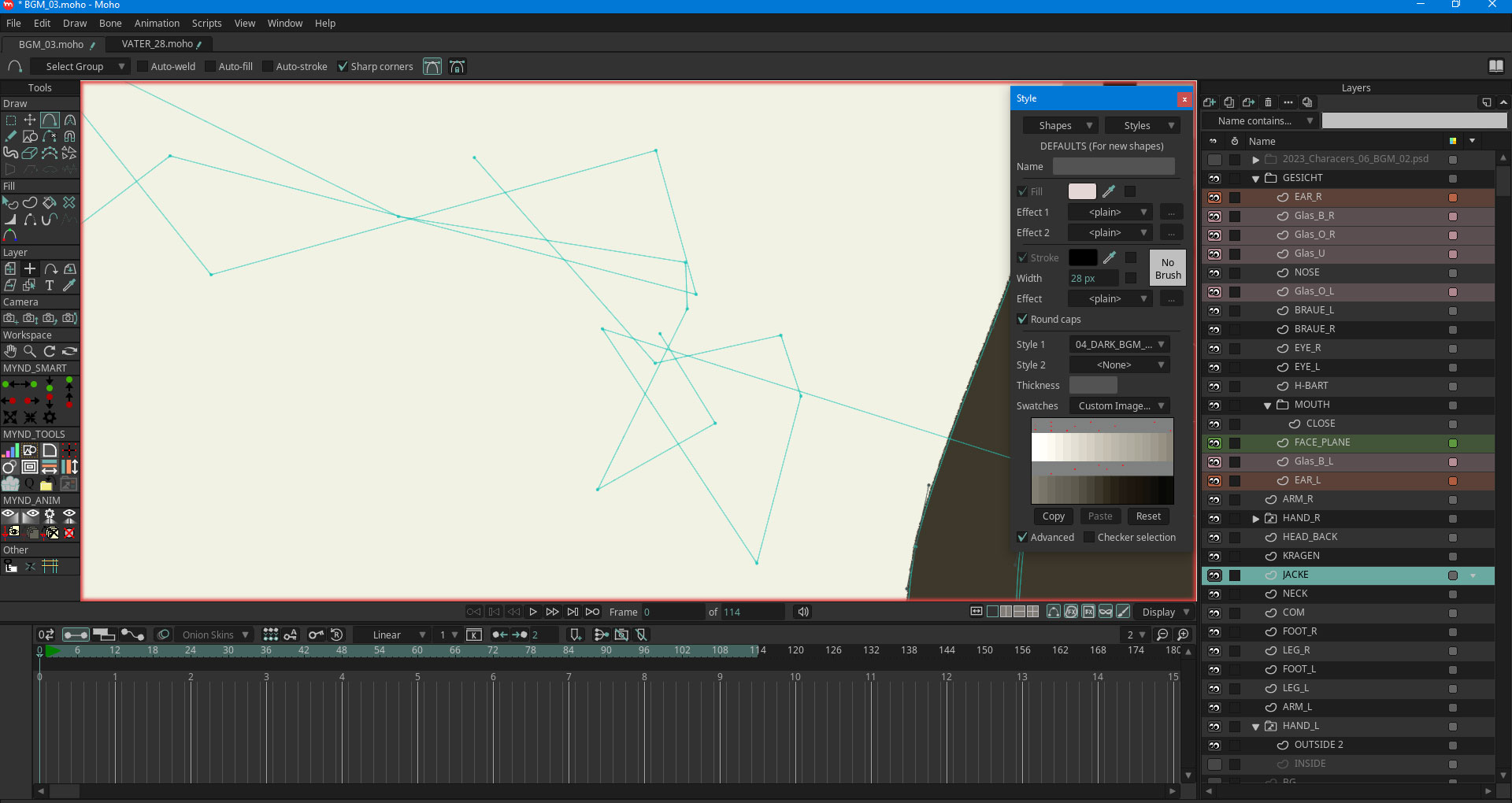

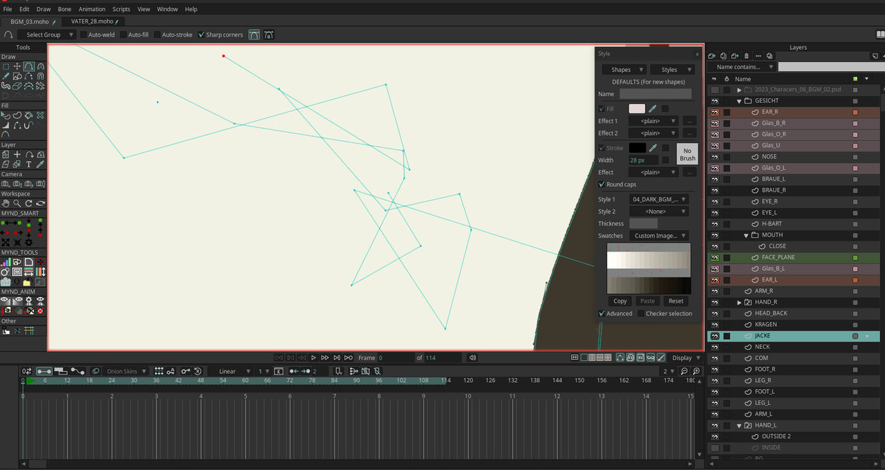

It happened again. I will try to describe it:
- Working with addpoint tool
- Suddenly it gets "stuck" = cant change tool through click, cant klick on menupoint (image 1 & 2), also saving through shortcut doesent work

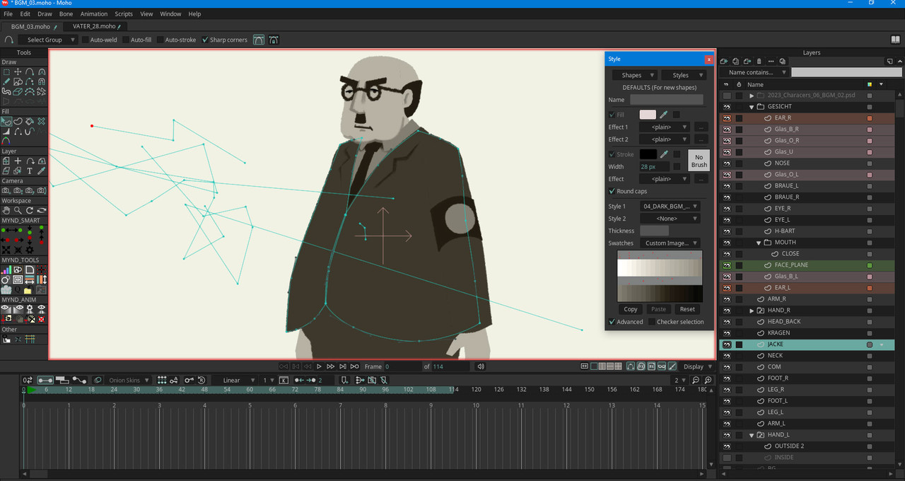

- the only thing possible is to choose another layer (not documented as screenshot). I did this and then could acess the save menu by click to save. I also could choose other tools in the toolbar on the left side but the function didnt change from the add point tool. it stayed stuck.

1) stuck in add point tool
2) Trying to hover tool (left). no change on klick
3) after layerchange (and then highlighting the same layer again...) Other tool active but still add point functionality
