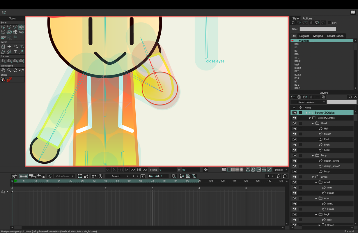

Gradients aren't bending properly with bones
Re: Gradients aren't bending properly with bones
One way might be to make two gradients, with the upper arm shape's gradient falling off to transparency. This way, when the upper arm image folds over, it has no visible effect. This idea might be overthinking the situation, but it just popped into my head. I'd mark this as something to try when every 'simpler' idea fails.

I should mention another thing I tried: Make the gradient only as wide as the arm. This idea was that when the arm sections overlap, the overlap would stay within the lower arm sections and any error would not be visible. Unfortunately, this didn't work the way I hoped it would.
Just thought I should mention it in case you were about to try this.
My current feeling is that you need to use an Image Layer with a custom Mesh Warp layer. This is the surest way to control how the image bends and have full control over the overlap quality.
Or...just drop the gradient and make the arm a solid color. (This is what I would do.)
Also, it's still a good idea to rig the arm vertically or horizontally rather than at an off-angle. I generally prefer vertical because that's the usual rest state of the arms during animation.

I really dont know how, or where to even start with all of this and its just making my head spin, so I'm thinking the best solution now would be to just give you the arm itself so you can take me through this properly. I'll prepare the file later and then give it to you. Thanks!

This idea is similar to the approach I used here:
That has a greyscale vector shape as a base layer with the rainbow gradient (png) above it with blend mode overlay. Both are warped using the same curver layer. They're in a masking group to constrain the png to fit the vector. (Shame the curver could be applied to the masking / blend group but ...) (the colour changes are achieved by varying the base layer fill colour)
I used point animation on the curver, but that could have been done with bones.

For the overlapping, the layer could be duplicated and masked, which is how I handled all the arm overlaps in our earliest DreamWorks TV animations. Later, I came up with tricks that made masking for overlaps unnecessary, but I think it's appropriate here.

Your gonna have to teach me how to achieve that mesh warp effect because I think that might be the solution! anyways here's both the arm rig, and the image texture in both png and svg form:

So I have some good news and bad news.
The bad news is that I realized the solution I said would help me earlier just will not work for what I'm going for. Only way it will is if the entire arm was just a png image but at the point I just called it quits
The good news is that I realized that changing the gradient handle actually makes a keyframe in the timeline. Although I tried it before and the handle just crazily spun around, I decided to give it another try and IT WORKS!!!!!

YES YES YES YES!!!!!!!!!! THE ARMS PROPERLY BEND WITHOUT THE COLOURS DISTORTING I'M SO HAPPY I GOT THIS FIXED THANK YOU SO SO SO MUCH I'VE BEEN TRYING TO FIX THIS SINCE DAY ONE!!!!!!!!!!!!!!!
One of the reasons I love Moho is that anything can be made into a keyframe, even this gradient handle. And that just so happened to be the solution, using an image texture and animating the gradient handle in the bones smart action to correct any improper movement with the texture.
