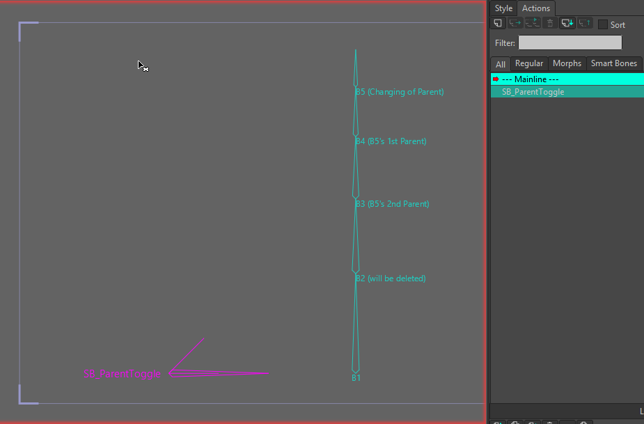

Hello there, here is my first bug report:
I'm using Moho v14.4 on Windows 11, and I've a bug while changing a Bone's Parent through an Action then deleting another Bone, here is my scenario:
  • I create a Bone chain with B1→B5 Bones. B5 is the last child.
  • I create a Smartbone that controls the parenting of B5: first it's B4, then it's B3.
Until here, everything is OK.
  • On frame 0, I delete the Bone B1 or B2 (with a smaller Bone ID than B5's one).
    (I use MR_Inspector to track the Bone IDs changes.)
  • Since then, if I try to edit the Action, Moho crashes.
The only solution I've found is to delete the Action that makes Moho to crash, and to recreate it's content with the new Bones IDs.
If anyone has a solution, other than not using Parental changes in Actions, that would be much appreciated and I'd be very happy to hear about it : )
