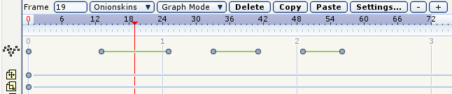

Now it is time to make the particles on /off during the time. If you look to the particle's layer in the example you will notice that there are three keyframes:
One at frame 18 that enable the particles on. Other at frame 24 that disable the particles. 6 frames is enough to throw a explosion simulation in my case. Last there is a cycle keyframe to repeat the explosion at a far frame (60) you can see that the green line (particles =on) is repeated during the time.
This is the basic particle firework. The rest is place more particles shapes, colors, etc. Also I've set a noisy keyframe (Scale=1; Step =48 (frames)) for the group layers that hold the particles but they are buggy (x,y,z) are not really random. I needed also some noisy rotation to make it more random in position. :(

The particles are On or Off from frame 0 depending on the value "On at start". If you set that parameter to Off then the particles are Off until you tell them when you want them set to On (and vice versa) . To toggle particles on/off just:
1) Click on the particles channel at the desired frame place and you automatically will create a On/Off keyframe. It is the same than the layer visibility channel.
2) Or alternatively right click the particles layer and a "Turn Particles On" or "Turn Particles Off" context menu will pop up, depending if the particles are already turned on or off.
3) Or, third option, click the Particle Layer button (at Layer tool area) and check or un-check the "Particles on" checkbox at the header of the main window. Notice that also there is a "Randomize" button there to allow modify the randomness seed for a duplicated particle layer (or if you like other random behaviour than the default)
