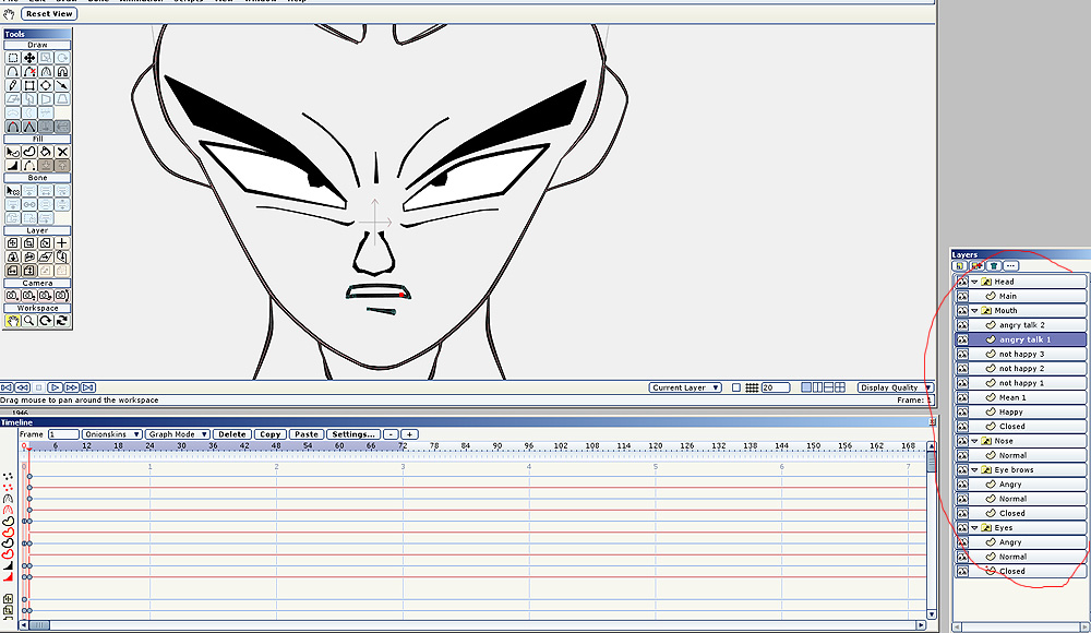

the what annoys me now; is what FRAME number should be those layers be created in initial stance? because i have noticed when i have been cloning some vector layers in order to pursue drawing new stances by modifying them (ex: mouth open, smile, sad etc) i have ran in to a confusing copy / paste & mirror problem where the what i have been trying to "paste" was a stance of another frame on the time line.

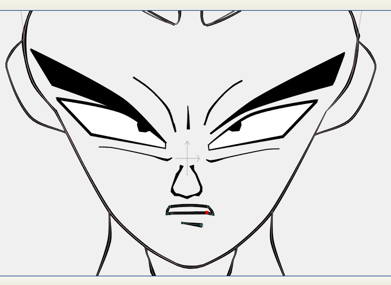

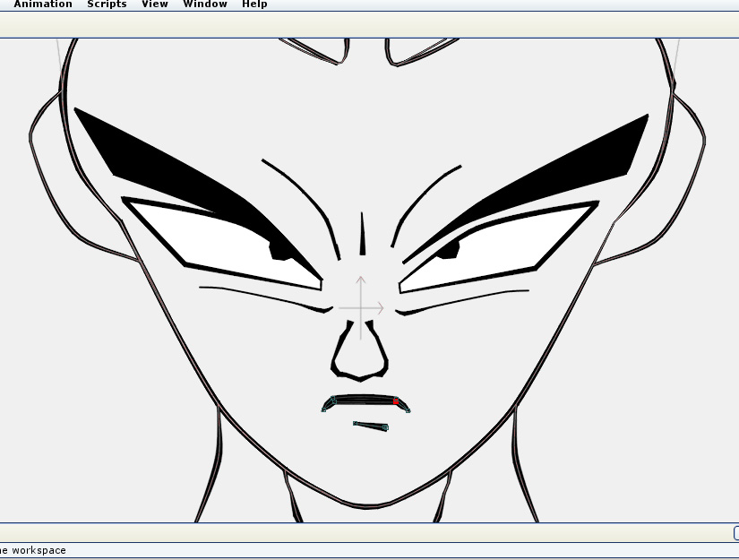

i probably got it wrong at trying to understand the workflow of this software, i need some expert's advice on building the correct layers structure for a complex animated face, please see here the example of what i have drawn out off hand;
