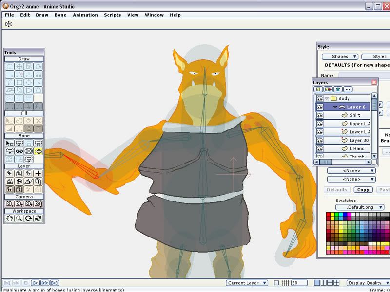

I'm having problem with stretchyness on my Orge character, pic here:
The left arm is ok,but the right arm is strectchy and also stretching the clothing.... :( I tried using the bone strenght,no effect,does anyone know how to fix this problem?Thanks.

2 ways. Either make a separate bone layer for the arms, or move the arms out away from the body before you place your bones, and use the offset bone tool on frame 0 to move them where they should be.
